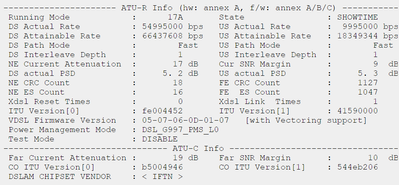

Thanks for your reply. I am actually using my own modem (Draytek 130). Here are the stats . .

so stats show still restricted to fibre 1 speeds and should get faster on fibre 2 maybe 64/18mb
check MYBT see if order completed  you could phone options team and they will help with upgrade 0800800030

You appear to be still capped at Fibre1 rates, you need to get back to customer services. You shoukld be getting about 66M if they remove the Fibre1 cap.

BT fibre 1 is 55Mb , not 50, 55 is roughly what your router is reporting, and a max attainable of 66Mb, personally I’m not sure I would upgrade for a relatively small increase in D/L although the upload could be around 18Mb....you probably should try your BT supplied router, if the administrator has changed your profile or stated the upgrade is complete, then perhaps a reboot or sync with your BT router may get you closer to 66/18 , if it doesn’t you need to call again.
