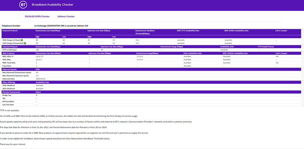

Re: Upload bandwidth keeps dropping to very slow speed
Thanks.  I'll try the noisy line test when I can.  For now, here's the speed test result right now (which is "good" 3meg up).  I'll see if I can get a result from there next time it drops to really bad too.
5,440 Views
Message 4 of 25
Your connection speed of 44/3mb shown on dslchecker is nowhere near the expected speed for your connection

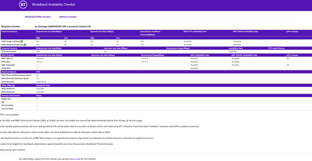

Ok, I managed to find a filter and have connected to the test socket through that.  The results still look the same:
5,379 Views
Message 10 of 25
Now in test socket it is hub stats you need to post as dslchecker results will be the same as it checks on your phone number not your actual connection
