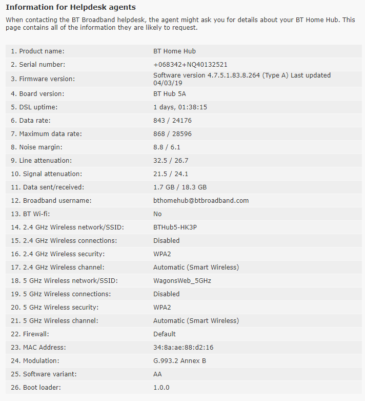

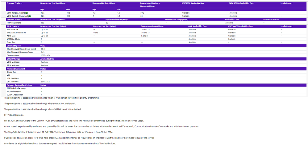

Recently my upload speed dropped from 3-4Mbps to 0.6. I have no idea why this happened and it is below what is expected. How can I get it back up to 3-4? Thank you.

@wagonface
Try a single disconnect of the broadband input to your home hub for about 20 seconds, and allow it to resync.
A loss of upload speed can be caused by a burst of high frequency interference, as the main upload portion on VDSL is situated at the top end of the frequency spectrum.
If the connection speed does not recover, and you have not made any recent changes to your internal phone wiring, then there may be an issue with the external line, but you need to check at the test socket first.

Thanlk you Keith. I left everything turned on and removed the cable from the back of the HH for 20 seconds. This morning the upload speed is a bit better, but not what it was before and not what I should expect according to BT. I havent changed any wiring in my house. Any suggestions on what I could do next?
