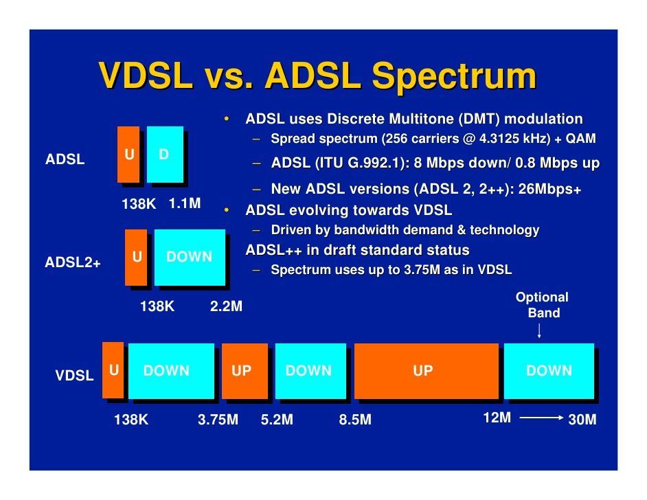

@Riley197 wrote:
Is it possible to dictate what frequency to be selected on? How can you tell which frequency you’re on?
This is the frequency spectrum. The upload connection speed is mostly determined by the high end frequency response of your line, which can be affected by the type of cable pair, and any interference that may be picked up.
