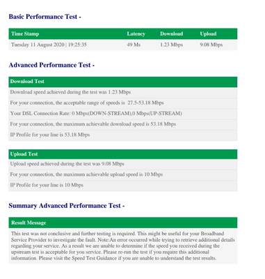

...and here is my report for the EVENING.
Screenshot_20200811-192646.pngThat's quite a drop!
As I say, it's been like this - every evening - for months. Can anyone please advise?
