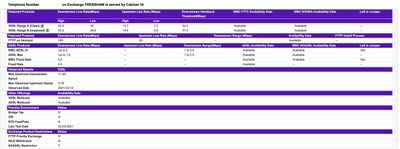

Connection stats (I think this is what you want):
Broadbandchecker:
Regards,
Lance

Any noise on your line? 17070 option 2, best with corded phone. You may get a dull hum with cordless.

your down speed should be nearer attainable speed of 34mb which is still bottom of your expected range according to the dslchecker results
have you tried using the test socket with a filter to see if that improves your conenction speed up and down
