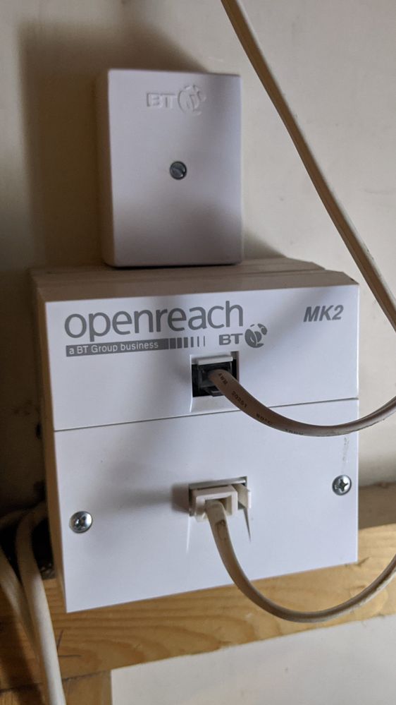

Here's the master socket.
I was incorrect in my previous post - the phone line doesn't pass through the filter box; the filter box is mounted immediately above the master socket.  This is all recent; a new line and new master socket were put in a couple of years ago.

That just looks like a connection box. A filter would upset your broadband.
Unscrew the front and see what is inside, I expect you will find just a connection strip.
Does your phone line come in from a pole?
Its possible that you are not going to be able to get a faster speed, but its always worth checking at the test socket, but you have to take the master socket apart, and you would need a microfilter as well.

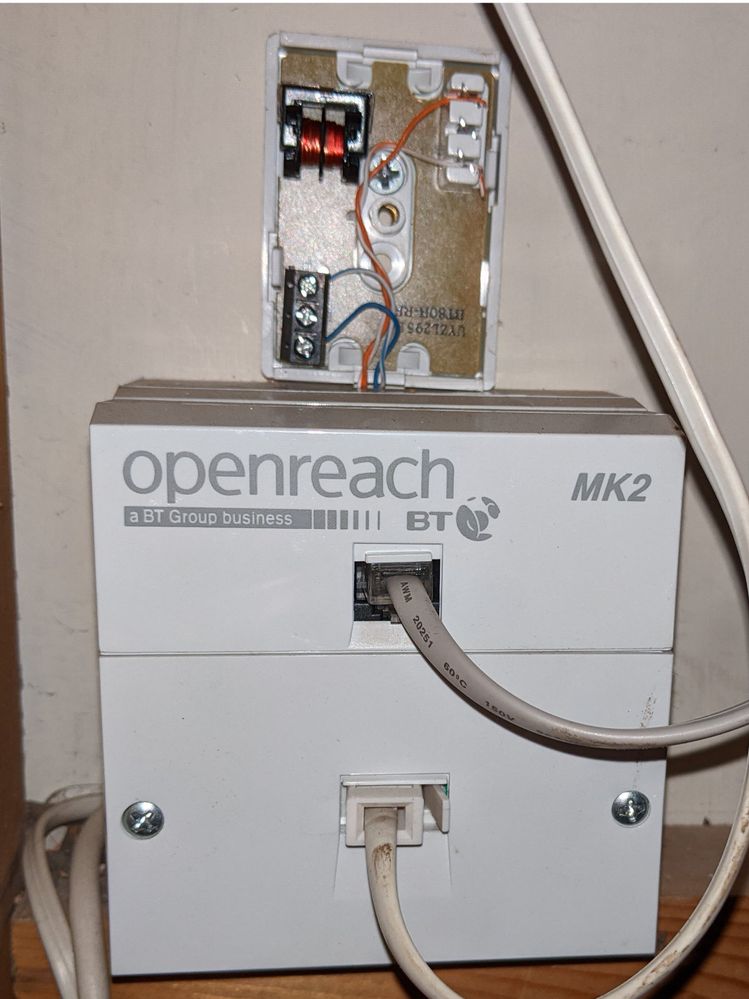

I've attached a photo of the contents of the connection box below in response to the previous request.

That filter should not be in circuit, as it will affect your broadband speed. Not sure why its there.
You should be able to bypass it by connecting the in and out together without using any of the existing terminals. Just join the two loose ends together, and see if it improves your speed.
Be aware that there will be 50 Volts DC across the wires, so make sure your hands are not wet, as it will tingle.

That reminds me of the filters we used to fit to prevent radio interference on phone calls, from nearby broadcast transmitters. This was before the days of broadband, and it looks like its never been removed. It may have been assumed that it was just a junction box.
Its not going to help VDSL.
