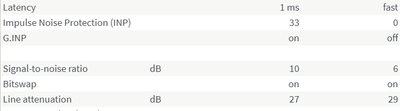

Sorry to be a pest but I have another question. Why is the SNR higher at the receive line than the send? You may have already answered this but I'm not sure. Does it have something to do with GNIP?

this may help with G.INP
https://kitz.co.uk/adsl/retransmission.htm
the first stage is to check for line noise and if present report phone fault
