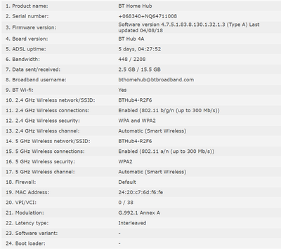

in order for the forum members to help please can you post the stats from your router (if hub enter 192.168.1.254 in your browser) and if  HH5 then go to troubleshooting then helpdesk and if HH6/SH2 then advanced settings then technical log information .

I hope this is the information you require.

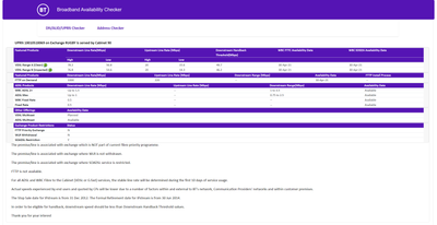

Dslchecker results??

That "UPRN" code was hard to find...

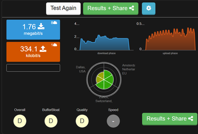

Also, here's a Bufferbloat test:

You can see from checker results the estimated date  for FTTC is April 2021
 adsl2 is available but I don't think it will improve your down connection speed but will increase your up speed.  However with a very long line like yours you may find a problem if there is even slightest line noise as DLM is more aggressive on asdl2
