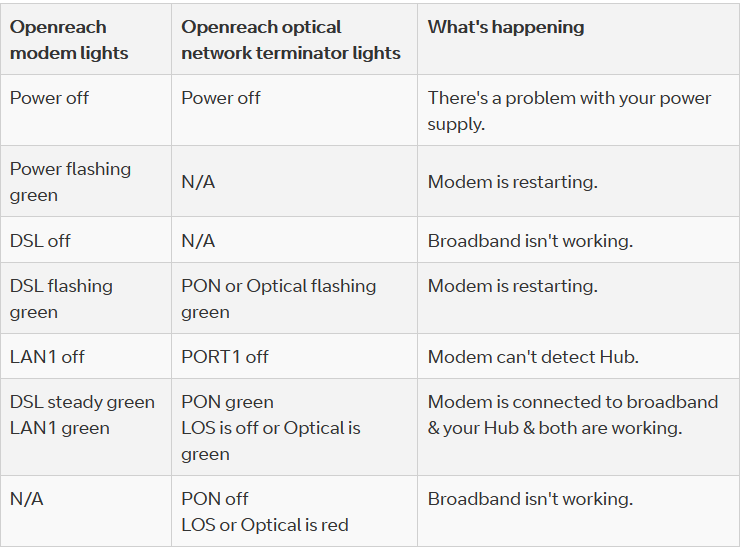

Disconnect power for the ONT for 30 mins and reboot. Possibly a faulty ONT.
2021-04-24 16_06_02-Openreach modem lights _ LOS & PON explained _ BT Business — Mozilla Firefox.png
