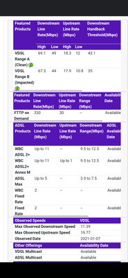

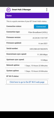

 are these screenshots helpful? I don't have a landline so cannot do the test you suggested. I get the same speeds on wired speed test too.
