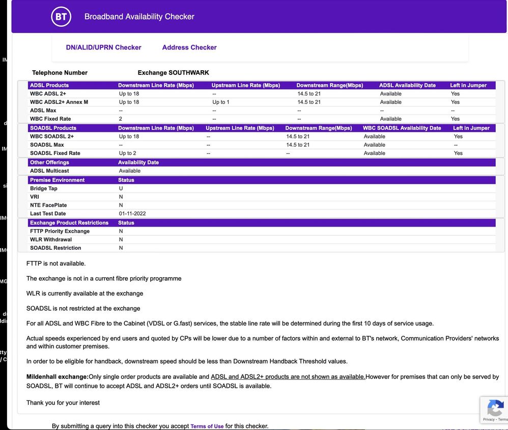

At first glance your stats suggest you are on adslmax instead of the faster adsl2/2+.
Are. You using the master socket ? Is it filtered socket or using a separate filter?  Have you tried using the rest socket with a filter?
Try quiet line test  dial 17070 option 2should be silent and best with corded phone
