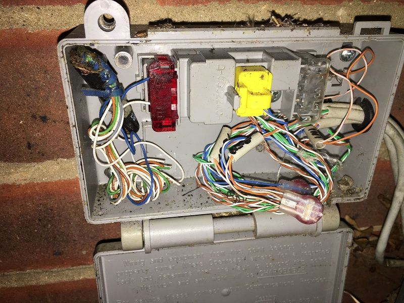

I have an external NTE installed to run my traditional fibre connection. (No FTTH available here.)
It has 3 UTP cables installed on the consumer (right) side: 1. phone 1 (does nothing at all), 2. phone 2, 3. internet. Both of them are connected via the orange / white orange simply.
In the house, we have the version 1 master socket some at least 10-15 meters away with double connection points (and no filters as far as I see) connected with one single UTP (cable no 4): orange&white-orange to the data, while green&white-green to the phone. (Cable no 4 is definitely not the same as cable No3 coming into the house.)
Which means the two external UTP-s are connected together somewhere to run to the internal master socket.
Is it the best practice ?
Or could this explain my connection issues? (Again I have no idea if the coupling of the cable 2 & 3 & 4 has been made by some proper shielded connection box or just connected the wires simply...)
Should I invest in cabling and move my master socket (and the HH) closer to the external NTE to eliminate the unknown junction between them?
Ext NTE
   NET               -------orange---------                                                              ----orange----------
(Cable 3)         -------or-white-------                   ?????                                 -----or-white-------         internal master
                                                                                              unknown junction        --------green-------        socket
   TEL                 -------orange--------                                                                --------gr-white----      (Cable 4)
(Cable 2)          -------or-white------

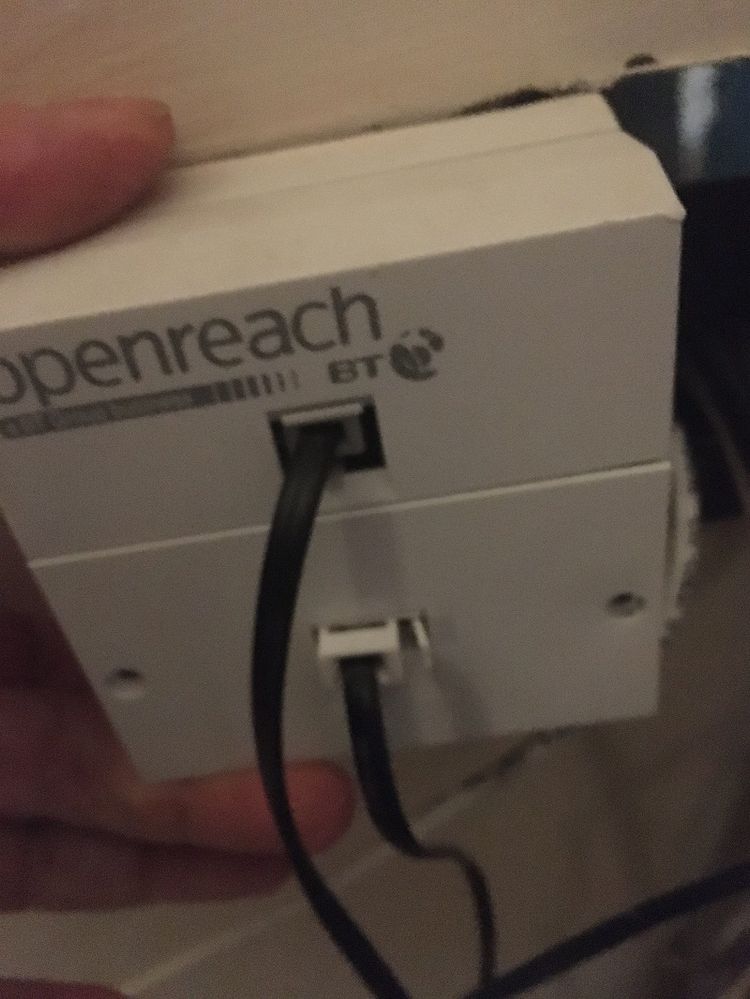

Pictures
Ext NTE box
external NTE with the cables  1,2,3external NTE with the cables 1,2,3Master socket with cable 4Master socket with cable 4Master socket in placeMaster socket in place

These external master sockets were a disaster for broadband as they created star wiring  with extension connected to line before the master socket.  I thought wiring in these was changed to go to master and then extensions were run fo master avoiding star wiring

I think my one does split of data and phone and does the star shape only for phone.
