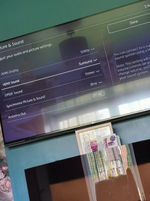

So don't know if you still are having this problem, but I've been having the same problem on 3 different boxes but have just literally solved it myself!!!
Go into the settings and change the HDMI sound from stereo to surround!!!
No more cracking noise. Was driving me insane.
