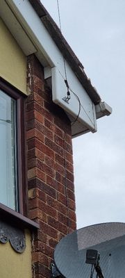

Thanks called team most answered but..does anyone know if its normal to anchor the new cable to soffit rather than brickwork?

Hi @grumpy_whale  and thanks for posting.
Can you post a picture of what you're seeing?

 so you can see iys attached to the white plastic/wood not the brick

Hi @grumpy_whale ,
Thanks for posting the picture. I think you should raise this with Openreach directly as it doesn't look like a safe installation. You can contact them at Tell us about unsafe, damaged or vandalised equipment .

Yes you can attach Bracket 22’s to UPV Fascia Boards providing they have a wooden board behind to secure the screws.
Also looks like you have the new FOD (Fibre Only Dropwire) Cable. It’s a lot lighter than the Hybrid Cable and also the clamps are designed to cut the cable when put under tension from say a HGV pulling at it.
