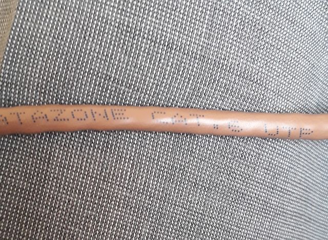

It is cat 6 cable according to the photo and my examination of said cable.Ethernet cable.jpg

You want a cat 6 cable and coupler then.  You can connect cat 6 with cat 5e, however, as the RJ45 plugs are the same.
The difference is that the cat 6 wire is slightly thicker, hence the internal bore of the plugs is a bit bigger, but externally they are identical.  Cat 5e will do 1Gb/s but has its accelerator on the floor.  (It was "enhanced" to get the old cat 5 up to 1Gb/s).  Cat 6 will do 1Gb/s easily and unofficially can do 10Gb/s at up to 55m.
The two are essentially the same, though, and will work together.  Of course, any link is only as fast as its slowest bit.
