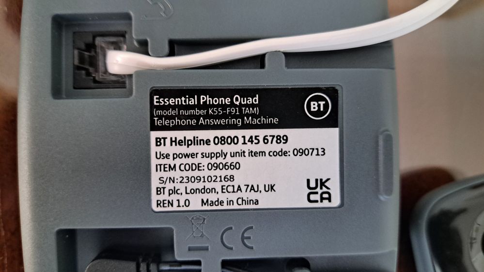

Hi. I have four BT K55-F91 cordless phones, including a base unit with a built-in answering machine. I've set it to answer after five rings so that it takes precedence over BT Voicemail (1571).
The phone works as expected for incoming and outgoing calls. We are able to receive messages, but these never have timestamps i.e. the exact date/time the call was received. This is very inconvenient, especially if we have been away for a few days and want to check messages on our return.

I'm struggling to find any documentation around the handset model that you've described here - could it be that this is a generic model number and it was sold with a different specific name?

And yet, bizarrely, the model number includes the letters TAM for Telephone Answering Machine! It's all very arcane...

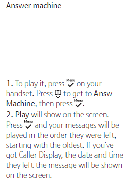

Is your Caller Display feature turned on and working properly?  There have been instances where Caller Display is deactivated or has stopped working following migration to Digital Voice.
Some people got it working again by turning it off and then turning it back on again, while some had to call customer services to get it working again.
I think the User Guide and Data Sheet for your phone are the following:
https://www.best4systems.co.uk/pdf-manuals/BT/BT%20DECT%20Handsets/BT%20Essential%20DECT%20Phone%20D...
https://www.best4systems.co.uk/pdf-manuals/BT/BT%20DECT%20Handsets/BT%20Essential%20DECT%20Phone%20U...
According to the user guide, you should get the date and time if you have Caller Display.

I’m not sure I follow ,as far as I know, the network CLI data contains the telephone number , not the day , date , time info , if the answer machine has a calendar and clock , presumably if it had the facility, it would ‘time stamp’ the messages locally not extract it from the network data .
I’m not sure what timestamp you were expecting, an audible one ? , the extract from the manual suggests this info is displayed  rather than read out before each message is played , I suppose the last point is you to confirm you have set the phone time and date otherwise the phone wouldn’t necessarily have this data onboard.

The TAM has a calendar and a clock. The time, day, month and year have been set correctly.
I was expecting an audible timestamp on the basis that every other TAM I've owned had that function. It's helpful for my parents who, as I mentioned, are elderly and struggle to read small LCD displays.
