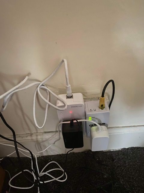

we don’t use the landline for a phone anymore but this is how we connect to the Bt router (picture attached)
Does this show that we have FTTP?

Whatever that second  is of , it’s not BT or Openreach equipment, if you have service from a telegraph pole you presumably will be able to see the cable from the pole to your house , and be able to visually trace that cable to the master phone socket and deduce if that old PO block terminal is part of your current wiring ….if it is , officially you should be asking for your service to be relocated before the windows are replaced, it’s pretty much the same if your service is underground ( possibly harder to locate though ) , from where the cable enters the house to the master socket , determine if the block on the window sill is part of the cabling route , and still ‘live’.
Only if you feel confident enough, and you have access to a ‘multimeter’ you could take the cover off and check for voltage, if it’s ‘live’ it will have 50v DC on it ( 50v isn’t a harmful voltage ) but obviously you would need to take care.
If the installation has never been faulty in the relatively recent past , and has pretty much existed as it is now for decades then it probably will be ‘live’ , however if the line has had work , for a repair or reinstall , it could be redundant but never removed as it would look worse removed than leaving it in place
