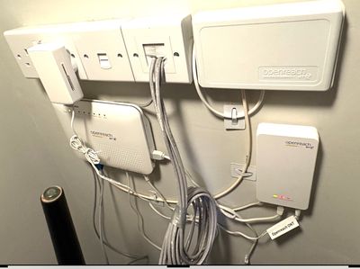

Hi Team
I am moving into a 8 year old house that  part of  which was previously  used as an office and BT supplied the internet .
The internet connection boxes (untidily installed in cupboard under stairs)
I am changing internet provider (probably   to 900gb fibre from Sky) . No phone requirement .
Regarding the  three BT equipment boxes shown in the picture , I understand the  modem (will be removed) and the ONT (fibre terminal with the lights , which has to stay ? can be switched off ?) .
 But what is the rectangular BT business box  function and can it be removed ?
Value your comments 👌

The 'boxes' are the property of openreach not BT RETAIL  so I would talk to your SKY installer

ok, but what is the function of the rectangular box above the ONT box ?

The rectangular box above the ONT , is the PSU (power supply unit ) for the BBU (battery back up unit ) as this is clearly a PSU as its plugged into a mains power outlet, I’m not sure you have identified the ONT correctly .
The box to the right of the mains sockets and Ethernet patch panel, which I think you are incorrectly identifying as the ONT is the CSP (customer service point )

On closer inspection you probably think the BBU is the ONT because the lead from the PSU is labelled as ONT , in this old style FTTP installation, the power lead goes to the BBU which powers the ONT , the power lead can also be connected directly to the ONT leaving the BBU out if the ‘chain’ , which in this case would make no difference as it’s in an alarm state because its batteries are now defective so in a mains power failure it would not power the ONT anyway .

If I have this correct then It seems that I have :
#  a Huawei  EchoLife 4 port ONT (will only  need replacing by the ISP  for speeds exceeding 1 Gbps)
# a now obsolete Battery Back Up (BBU)  which can be disconnected  with the psu going direct to the ONT .  (only previously used for Voice Telephone backup )
# an internal Customer Service  Point (CSP)  , where the incoming fibre cable ends and a fibre patch cable takes over connected to the ONT
Thanks all 👌
