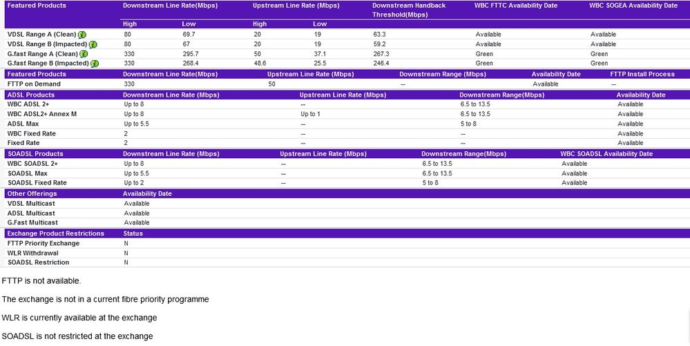

The broadband availability checker for my address claims it should be able to deliver between 67-80/19-20
Fibre 2 claims averages of 67/19  as well, and I can only assume that for ease of switch-over, someone decided to keep the settings from the previous provider instead of running a new test and in fact shaved some upload speed off for good measure.

can you post your hub stats advanced settings then technical log information
can you also post results from https://www.broadbandchecker.btwholesale.com/#/ADSL
if you have no phone number or digital voice then use your address
you are not in a banded profile but maybe the wrong profile

Here's the address-based speed thing bt broadband speed.jpgI've just found the debug page of the Netgear D6400. I won't pretend to understand it all and there is more but hopefully this contains the pertinent information. I'm loathe to replug the smarthub in case something at the other end decides to consider it a dodgy line and downgrade me to ISDN or something 😄

Hi @BeckiJane
Welcome to the BT Community and thank you for your post!
I am sorry for the problems with your broadband speed.  Can you post your Hub stats and a screenshot of the results from the >> BT Broadband availability checker << please?  Ultimately, you should have been put on a package to reflect the broadband speed available at your address.
**Edit** Our posts crossed.  Thanks for providing the info.  It's a profile mismatch.  You should be on a 80/20 profile on Fibre 2 but it looks like you're currently on a 40/10 profile.  I have sent you a private message with instructions on how you can send us over your details and we'll look into this for you. See: Private messages

@RobbieMac
looks like set on fibre 1 profile and should be fibre 2
@BeckiJane
can you check MYBT and make sure it shows fibre 2 not 1 in package
