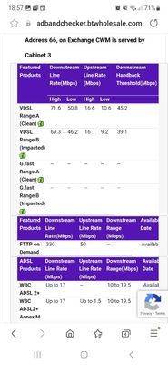

I'm definitely on Fibre 2 that's for sure. So what could be going on?
 Many thanks

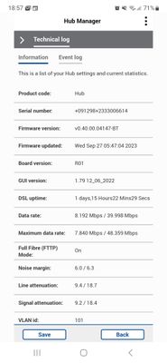

Oh and router stats...

Whether you are on fiber 1 or 2 that would not affect your attainable speed and that shows speeds well below expected range from dslchecker
Have you tried connecting the hub direct to the test socket with a filter and then repost your hub stats ago see if any improvement
You can also change the FTTP setting from on to off.  This only affects ethernet port 4

The faults have caused DLM to band your line at 40M.
