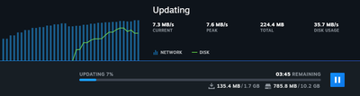

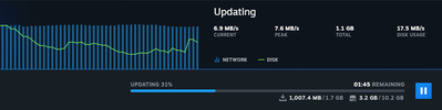

It could be a number of things, the CDN source for the downloads is at capacity, it could be compression as the downloads are unpacked (certainly impacts FTP downloads), bad sectors on your HDD.
Steam downloads for me will also rise and fall, I had a few downloads scheduled, I set them away and the results vary
My download settings if it helps, location chosen is London even though I'm North-East
