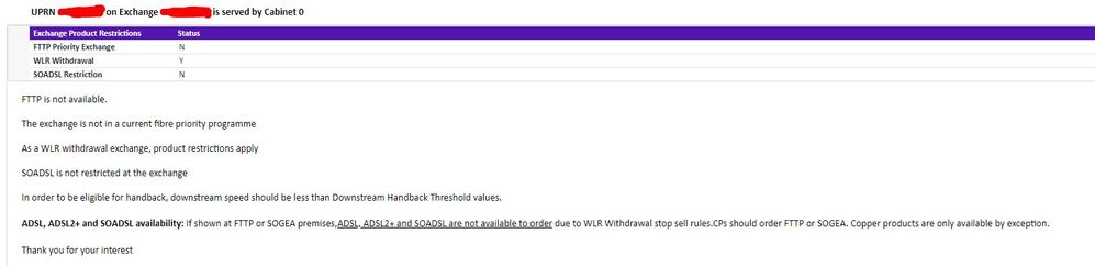

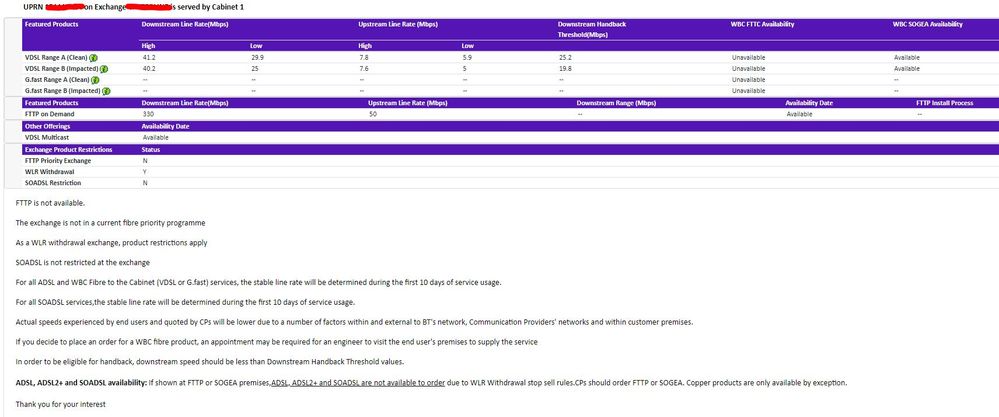

To further add to my investigation I found our UPRN for our house and did a check with this, the results are different again..
OUR HOUSE
NEIGHBOUR
To summarise our UPRN (CABINET 0), Address (EXCHANGE) and landline (CABINET 3)  ALL give different speed results.
Our neighbour gets the exact same speed results for UPRN, Address and landline (CABINET 1 for ALL)
