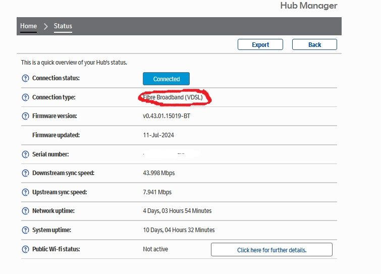

@RedSquirrel  If you have a Smart Hub 2, it no longers shows the modulation type in terms of ITU G.xxx it just shows 'Connection type' as VDSL or (presumably) ADSL in the Status tab.

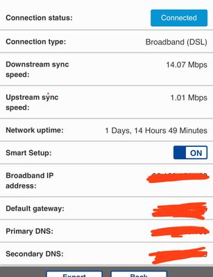

Message 27 of 31
Re: BT Wholesale Checker - Landline Number v Address
That confirms you have ADSL and not FTTC (VDSL).
