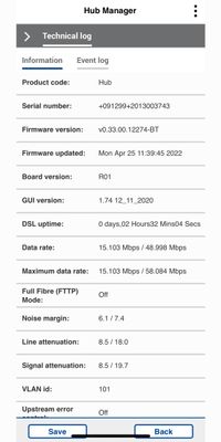

Noise margin:6.1 / 6.3
Line attenuation:8.5 / 18.0
Signal attenuation:8.5 / 19.7

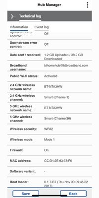

Are you on an ECI cab or an Huawei? We can't tell as you've removed the exchange and cab number from the checker result (and yes, it does make a difference).
Also you've posted the status page which gives limited info. Go to Advanced settings/information/technical log.

I am on a Huawei I remember from looking previously. Post code is IP27 if you want to check. Additionally, I will post the other pages shortly just annoying having to compress etc, I will post in a few minutes thanks for your help.

Here you go. Thankyou for your help.

If you are on an Huawei cab then your noise margin is not what I would expect it to be. If ECI then yes.
I've well over 100 images uploaded here, never once have I had to optimise them. They have always been crisp and clear and easily readable.

Yeah I know, Apple is **bleep** for things like this. Can you read them? If not let me know and tomorrow when I’m home I’ll send you the information from my computer. Thankyou. Also does the noise margin seem alarming? I think I need an openreach engineer out to have a look at the issue tbh. I’m not sure though.

Your uptime is only 2 1/2 hrs, is that a reset by you? If not it would appear DLM has taken action as your line is unstable.
If you have a copper connection and not digital voice try a quiet line test 17070 option 2, best with corded phone but you may get a dull background hum via cordless. Any noise trport a noisey line, not a broadband issue, once the line is sorted your broadband should return to the higher speeds incrementally over a couple of weeks as DLM sees the problem resolved.
