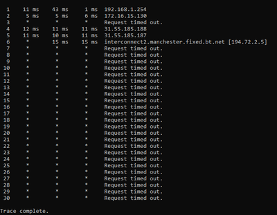

traceroute to fuze.com (54.204.252.11), 64 hops max, 52 byte packets
1 192.168.1.254 (192.168.1.254) 0.862 ms 0.658 ms 0.491 ms
2 * * *
3 * * *
4 31.55.186.184 (31.55.186.184) 3.877 ms
31.55.186.180 (31.55.186.180) 3.766 ms 4.352 ms
5 * * *
6 * interconnect2.manchester.fixed.bt.net (194.72.2.5) 10.650 ms 10.187 ms
7 * * *
8 * * *
9 * * *
10 * * *
11 * * *
12 * * *
13 * * *
14 * * *
15 * * *
16 * * *
17 *^C

We can at least confirm not just you thankfully. I'm not sure if BT sends *all* US bound traffic through that manchester interconnect, but certainly a large chunk of it seems to go through there - and whoever they're trying to handover to is having a bad time.
As such, traffic seems to be going missing in Manchester when destined for US Services 😞
