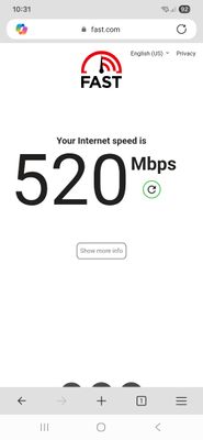

It's up to you if you want to believe @Anonymous but this is what I get on a BT 500mbps package using wifi on a mobile phone on my home BT Broadband using a Smarthub2.
