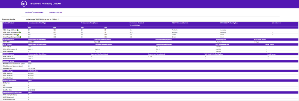

Looking at the data below, it looks like DLM has reduced my speed to try and contain this, but clearly, something is not right, as the disconnects continue even as the speed gets dropped.  I have requested another engineer visit, but I am not confident that this will achieve much more than a line check that passed ok on the 27th?

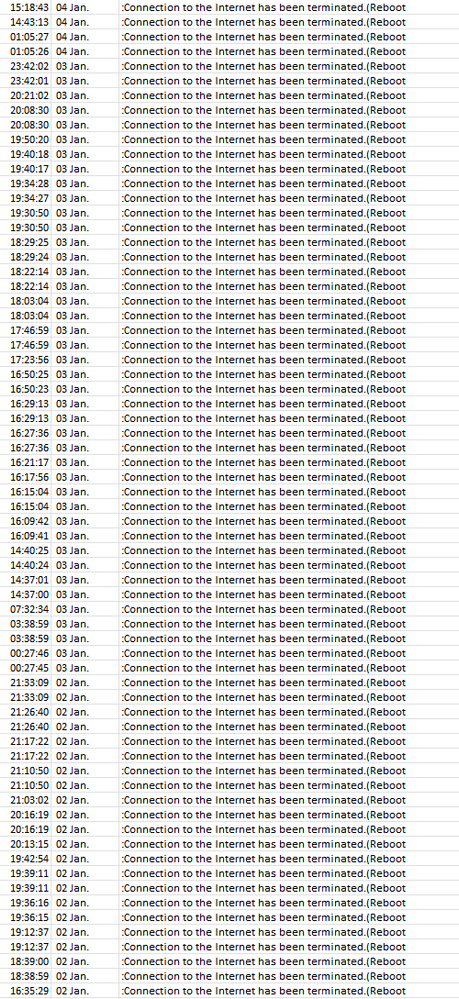

Any thoughts, please? The router logs below show an example of the disconnect frequency in the last couple of days.
