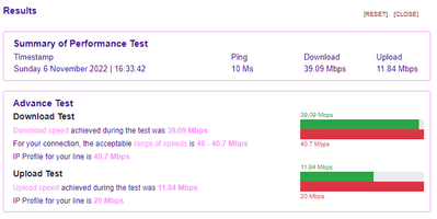

Broadband seems limited to 40/20 on a 45 Mbps guaranteed contract
Hi
I've seen mods in this forum were very helpful to people with config issues for their profiles so I'm hoping that one such kind heart will help me out.
I recently moved properties (from Lancashire to Cheshire - may be important, later about that below). I didn't mind losing the old phone number as I was advised it will be changed. On the day of the switch and 2-3 days after my Steam was happily downloading things at 60+Mbps no problem. Then, about a week after, the connection got reduced to this, with this speed being almost constant, no drops, it is always less than 1Mb in that range.
Now, my contract is the 45 minimum 55-76 range one, while on the previous property I had the lower tier one as max what I could get was sub-30Mbps speed (Prestwich, Manchester, where we send internet by post - not BT fault, cables are from the 80's and no one wanted to remove trees to change that). This profile looks almost IDENTICAL to the one I had at the old place. Furthermore, when I get texts from support, for the account search it actually quotes the OLD phone number, which is very weird.
As the speed is below the minimum, I contacted tech support and an engineer was sent to the new property, confirmed nothing looks incorrect on the premise and said he will add a report that there is potentially a fault either in the cupboard or cables so that gets checked out. Unfortunately, after his visit I got a text that the issue is now resolved, work order closed and it should be fine now, bar restart. Nothing changed at all.
Spoke with the nice lady at the help-desk about that and she offered to send me a new router (mine is old hub 5, but it was working at 300+ speeds already so I don't think that would be an issue - maybe?). My idea is that this may be something related to the landline transfer going badly, myBT still reports this for my landline, even if the switch was supposedly completed 2 weeks ago:
I hope that some kind mod can help - otherwise my contract has a auto-exit option now as with that setting the minimum is never possible.

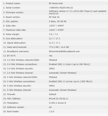

Can you post stats from your hub.
If a new home are you sure you are using the master socket?  Have you tried using the test socket with a filter and see if that improves connection speed.

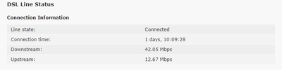

Hey - and thanks for the answer. Apart from the above, on my hub you can only get this, unless you mean report from some other tool:
Speed is roughly the same (less than 1Mbps deviation)  on all sockets. No way to check the landline as I don't have the set at all, never used it, I keep the landline just for various odd things that require it like proof of address etc. I'm using a filter as always.

For the HH5 you need to go to Troubleshooting/helpdesk to get the info requested by @imjolly
4,132 Views
Message 6 of 11
Re: Broadband seems limited to 40/20 on a 45 Mbps guaranteed contract
Thanks for the info, much appreciated - here's the data:
If you are using a filter then I assume your master socket is not a new filter socket with 2 outlets - phone and router.  so have you found master socket and then removed faceplate na d with the filter connected to the test socket to see if that helps by eliminating all your internal wiring - that assumes your internal phone wiring is correctly configured
4,106 Views
Message 8 of 11
Technician that visited us on Friday did that, confirmed that it is OK - then the fault got closed as resolved because I apparently told them it is fixed. I never did such a thing. I was initially positively surprised as the text said the issue was resolved and to restart the router (which made no difference). He also tested all of the secondary sockets and every single one was ok but returning the same values.
And yes, you're right this is the older single port socket.
