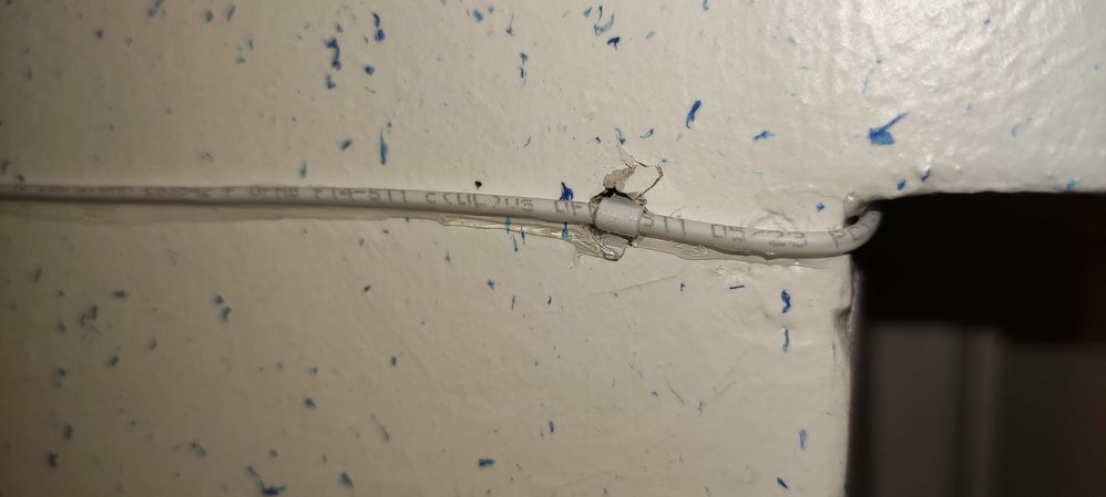

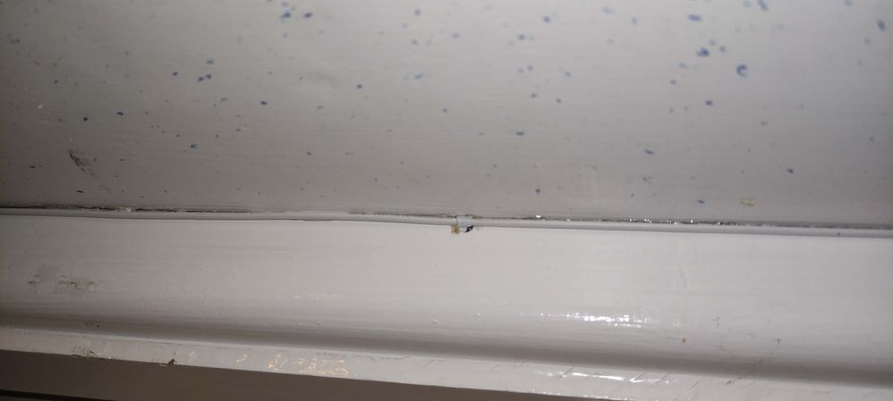

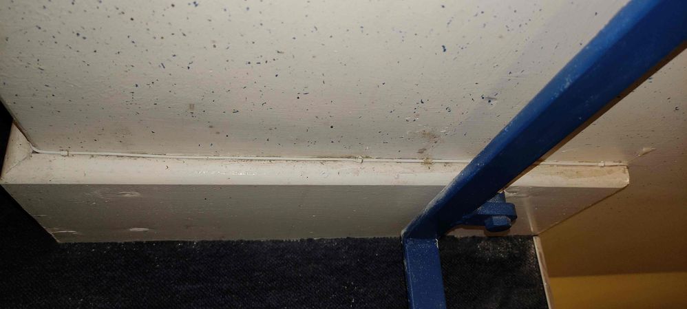

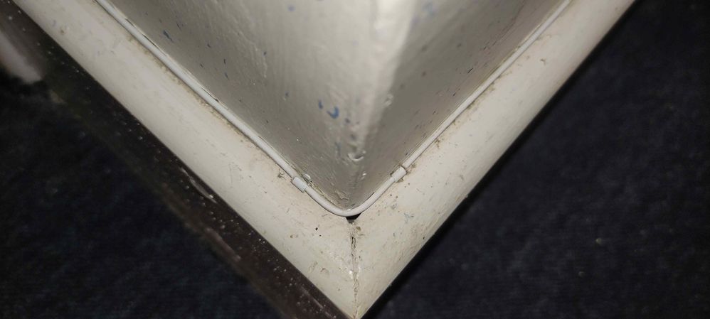

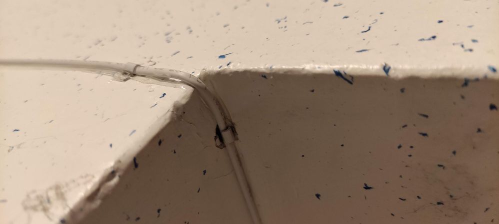

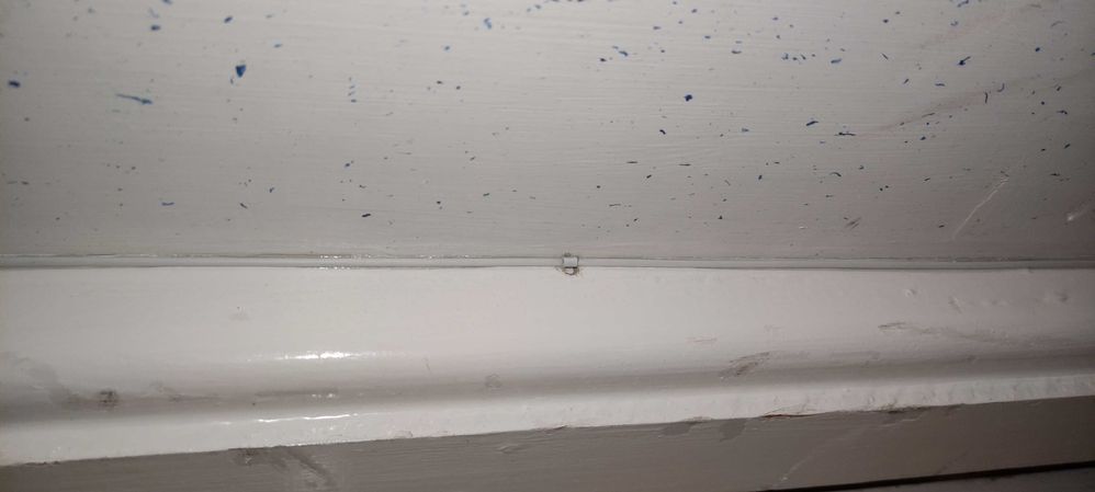

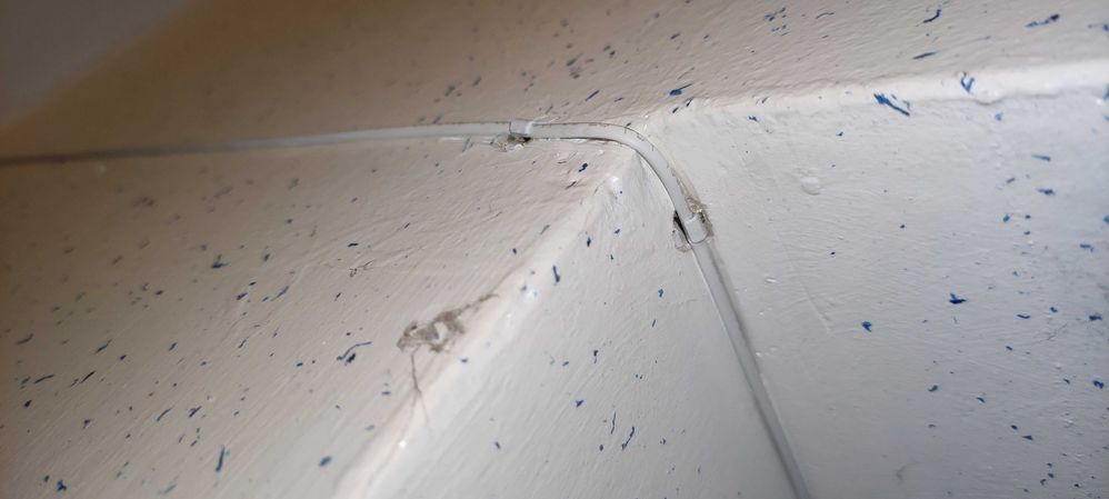

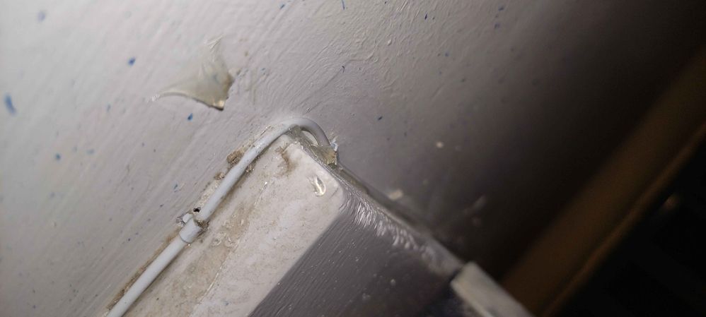

I'm concerned about the quality of the install, especially the number of 90 degree bends.

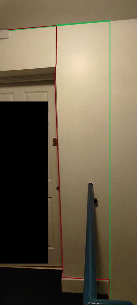

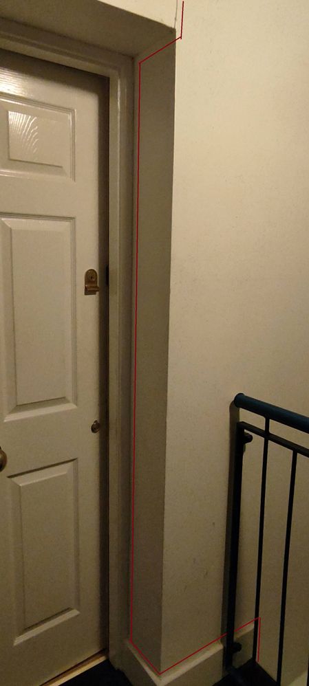

Secondly, are all the 90 degree bends in the cable really needed? Some look rather sharp. Couldn't the cable have went straight up the wall? It would've been behind the hand rail, out of the reach of anyone.
The red line in the picture traces out the route the cable takes. The green line is what I think would be a better, straighter route. Why would they chose to follow the skirting board and door frame?

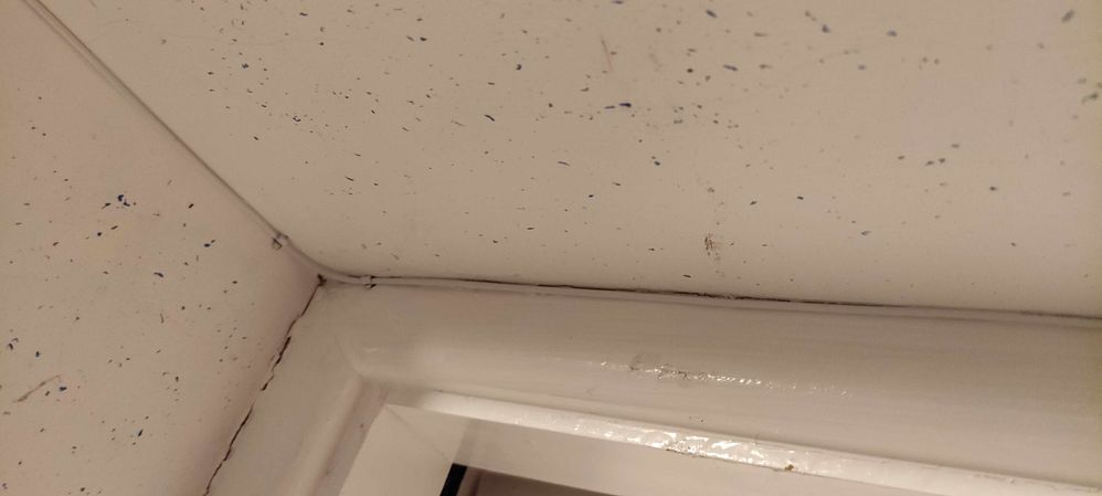

They have also attached the cable to the skirting boards and my wooden door frame. We have cleaners that come in and clean very quickly without care, always banger the vacuum cleaner into the skirting boards, and could damage the cable. I also plan to repaint my door and frame in the Spring, but now won't be able to sand the frame and properly paint it due to the fibre cable being attached to it with glue and tacks.

just from your photos all the bends are rounded/curved whereas your lines have right angled turns which are no good to fibre

Of course my MS Paint drawn lines would be straight. They are just an indication of what I think would be a better routing. It's hard to draw curves in paint.
The Openreach install handbook says to avoid 90 degree bends as much as possible. There's a few that have quite a tight radius, especially around the door lintel area. The cable looks stressed there. I'm asking if having this many bends, instead of straighter runs which were possible, will cause problems.  They could've avoided five 90 degree bends if they went straight up behind the handrail instead of routing the cable around the skirting board and up the door frame. Is there a reason a straight run up to the ceiling would be avoided in an install like this?
Also, is attaching it to a door frame with tacks and glue typical install practice for invisilight?

There will be a reason it was done that. The easy route is not always the best. As longas the radius of the bends are within spec there will not be a problem.
It is difficult to see correctly but your straight line route would appear to make the cable more vulnerable to being damaged by people passing by if they or something being carried bumped into it.

It's hard to see from the pictures but the stairwell is very large area (tall and wide) and a cable ran up the wall would not have been accessible to anyone on the staircase. Moving furniture on the staircase does not enter that area. That area would've only been accessible by leaning over the rail with a stick.

Given what you have said it may be that special equipment would have been needed to work at height in a stairwell.
What ever is said on the forum is only speculation as only the installer can say why he routed it the way he did.

A bend in an optical fibre introduces a loss , even in a straight cable run there are losses  , but a bend , especially a ‘tight’ bend causes more loss ( more light can escape ) if the cumulative loss becomes too much then the power level at the ONT would be insufficient for the equipment to sync to the headend , so ‘bends’ in the fibre run although undesirable and avoided if possible, are not necessarily going to stop the service working,  optical systems are not like ADSL/VDSL that are rate adapting, where the greater the loss the lower the sync rate , it’s if the power level is OK ( even if it could be better without the bends in the cable ) it’s going to work …obviously if those bends have introduced too much loss then it won’t work , so unless whoever installed the cable has tested it for loss ( and that’s not very likely ) you won’t  know  be until it’s tried  if it’s OK  or not , but if you were in a new build , this cable  would be installed at first fix , so anything like this would be hidden from view , and in that case you  would be in a state of ‘blissful ignorance’ .
I would  say no reason to worry ( yet )  , if by chance the losses are too great then these  bends would need to be addressed.

They did only come with a little step ladder, just tall enough to reach the top of the door. They'd have needed a more sophisticated step ladder and platform to safely reach the top of the ceiling from the stairwell (Other than dangerously leaning over the rail). I never considered it being a lack of equipment issue. Thanks

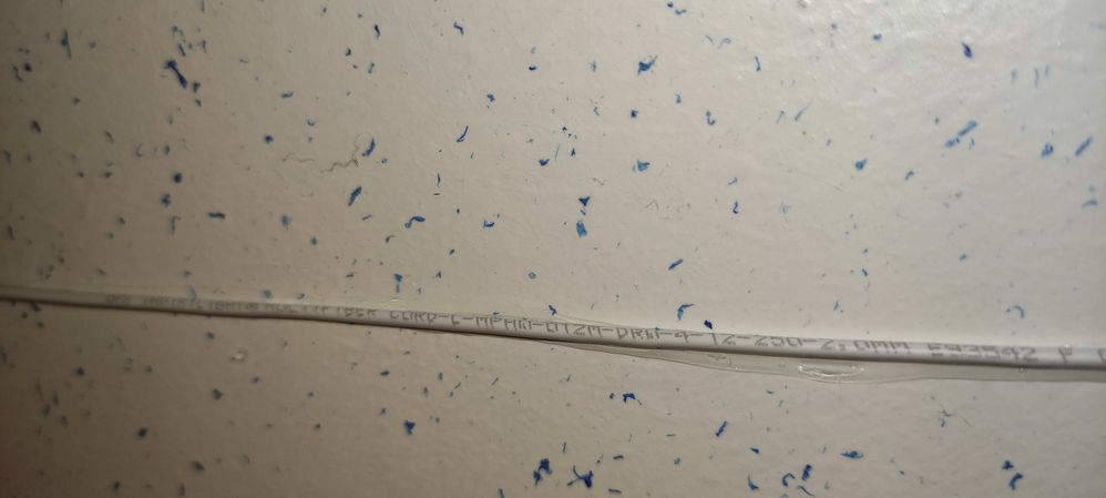

TBH , I don’t understand the way you describe what they have done , although each ‘leg’ of a splitter is optically identical, one fibre cannot service two ONT’s , unless another splitter is used and that isn’t how Openreach build their  distribution network ( they don’t  have a second splitter downstream of the splitter node ) so you would expect an individual fibre for each flat from the point where the splitter is located ,  even if some of those individual fibres are within the same fibre cable , unfortunately the images you posted of the COF ( cable optical fibre ) don’t show the markings that would confirm the cable size .

The Metal Tacs are absolutely a necessity as they’re there for Fire Regs to save peoples lives in the even of a fire.
If they weren’t there I’d report it immediately to the MA to get Openreach and or their Contractor out to put them in immediately and if they didn’t the Cable should be removed.
Ref to the Build I’d say that’s absolutely spot on.
