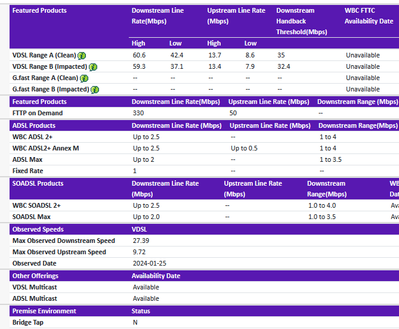

can you post results from dslchecker
That threw up a page of stuff. Anything particular to look for?
Post it how? Does this work?

the checker shows expected range 60/42mb and currently connection 27mb at 25/1
are you able to post connection stats from your router - connection speed, noise margins etc

You are not going to get 70mbs, as the speed range for your line is 42.4Mbs  to 60.6Mbs.
