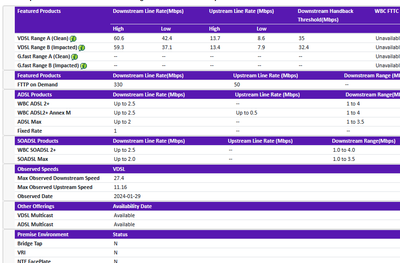

The Hub Manager reveals a Max Observed Downstream Speed of 27.4 Mbps. So something is broken somewhere on the network.

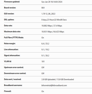

can you post stats from the SH2 - advanced settings/technical log information
have you tried connecting direct to test socket with a filter to see if that improves connection speed

I'll play with the plugs later, meanwhile:
I'm more used to the maximum data rate, and often get better.

There is something seriously wrong with either your line or the DSLAM in the cabinet with a noise margin of 25.2 for downstream but a normal 6.4 for Upstream.
Only an engineer investigation will resolve the issue.
