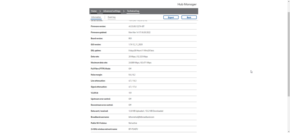

Router/Modem - Smart Hub 2
when I run speed tests my download speed is fine, but my upload is very bad. I normally get around 15mb/s upload and I'm currently getting 0.3mb/s.

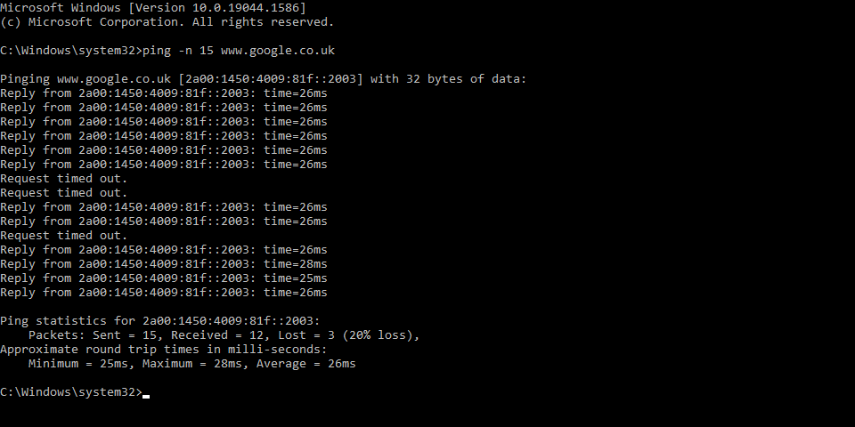

I've ran CMD commands to ping google.com etc and I get a lot of "request timed out".

You need to test whether this is an internal problem, especially since Openreach says the line is ok.
When you see these requests timing out to google; what device, on what connection, are you using? If ethernet, are you connected directly to the router?
At the time this occurs, you should also issue requests to your router and see if that times out - if it does, the problem is in your house.
"ping 192.168.1.254 -t" - this endlessly pings the router. The router is usually at that address. Press Ctrl + C to end.
It's best to run this test during a period of high packet use, such as when connected to a high tickrate game server, in order to stress the connection in a way that could trigger the issue.

No surprises as we suspect v0.33.00.12274 firmware has issues - still waiting BT to acknowledge it has bugs.
Search for this tag
v0.33.00.12274

My new hub has turned up since running firmware version v0.24.04.11017-BT and my speeds as normal.
Nobody wants to admit it's the firmware it seems.
