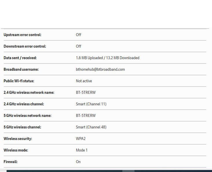

can you post the full stats from your hub - hub manager/advanced settings /technical log information

Many thanks for the quick response. Please find attached the current stats from the router.

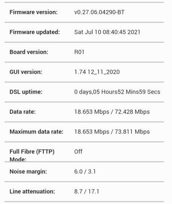

Please see below what the original speed was when the broadband was initially installedSpeeds when broadband was first installed.Speeds when broadband was first installed.

due to the drops and/or resets of your connection you are currently in a banded profile.  this should release automatically but you need 7/10 days stable connection before that will happen.  when that happens then your connection speed should increase to near attainable speed with noise margin about 6db.  if you can maintain a stable connection then G.INP will be active and drop noise margin down to about 3db which will give a boost to connection speed
as you can see when you had the higher speeds your noise margin was down at 3.1db
until you can get stable connection your speed is not going to improve and any DLM reset is pointless
