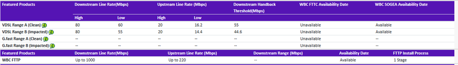

I have also checked BT DSL checker and I get the following stats back. What does the Downstream Handback Threshold signify?

the drops in connection have resulted in DLM taking action and increasing noise margin again with corresponding drop in connection speed.
Looking at your dslchecker results you have FTTP available to you and would be better to upgrade bearing in mind the package cost is the same for FTTP as it is for FTTC
