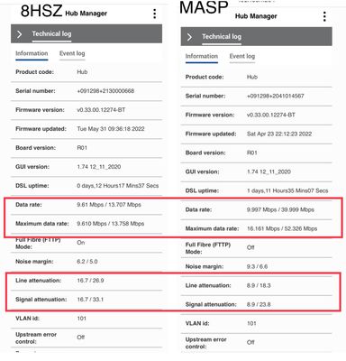

Over the last two days the older household account has dropped to a third of its usual speed.  It is steady on 10Mbps even with all connected devices offline.  The newer account gets the 34Mbps which was common to both accounts until recently.
I’ve done the usual things like rebooting the affected Hub but to no avail.  Would appreciate any ideas or thoughts people have, thanks.
Tech logs below (8HSZ is the affected Hub)

I would guess 8HSZ has developed a dis one leg fault. Does it have dial tone?
Or could it have been reverted to ADSL?

@dave44  and @imjolly  thanks very much for the input.  I've just plugged in a phone in - noise on the line (a cordless phone) and no dial tone/can't dial out.  Looks like a fault on that line then.  I'll get on to BT 😊

@stickybloke You have FTTP Mode on you might want to turn that off if you do not have an FTTP Connection..
Also, If theres no dial tone are you sure you do not have a SOGEA line (Broadband only) for the affected line? Get BT to check this too.
Massive discrepency between the line attuentions too.. Very bizzare!
