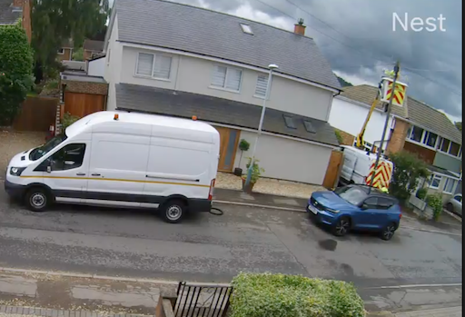

Thanks @Starwire  - a review of my Nest security camera from a few days ago is quite revealing... 😃

They’re the kind of Vans Contractors use, specifically the ones who do Network Build.
Thats not FTTP they’re putting on that Pole is it?

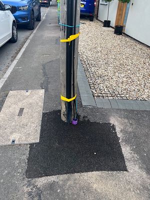

😃  I’ll be honest, I wouldn’t know an FTTP installation if it punched me in the face whilst wearing a “I am an FTTP installation” t-shirt 😄
They’ve done something there - new tarmac and two new cables running up the pole to something technical at the top 👍🏻

Purple duct upto the pole , suggests it’s an ‘Alt Net’ ( Alternative Network Provider ) that is putting their kit on the Openreach pole ( may also explain the contractor vehicles in the image  ) , no doubt when putting their kit on the pole they have managed to disturb your line and  put a fault on it .
