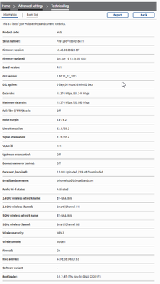

Can you post a screenshot of your hub stats please?
2,481 Views
Message 10 of 17
Re: FTTC Broadband speed after pole replacement
Go to solution
Hi licquorice, is this what you need?
