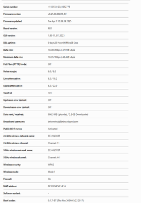

Post a screenshot of the information page in the technical log part in router admin page.

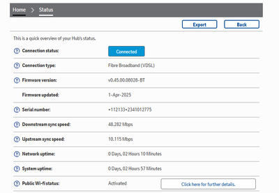

here you go. means nothing to me 😄

The uptime is only 5 hours.
Your noise margin is 6dB which is the default starting point for DLM. Give it a few days without rebooting the hub and DLM should reduce your noise margin to 3dB which will give a speed increase.
TBH, the only way you are going to tell the difference between 48M and 55M is a speed test result. In the real world you won't tell the difference.
