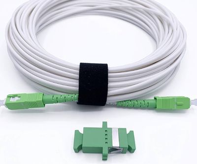

Search Ezibend optical cable to get an idea ( image) of the type of cable used , 6mm seems to be the consensus for the size of the hole required to pass this cable through.
Obviously the hole needs to be slightly larger than the cable , but the external side should be sealed with silicon to stop any water ingress, OR also use a cable that has a rugged outer jacket that remains on the external part of the cable run , and is stripped off to expose the internal white jacket to give a better appearance internally .

But there’s nothing stopping you from buying a cable with SC/APC Connectors at either end, along with a Coupler though and an essentially extending the Fibre Cable Openreach install.
Of course like Extension Sockets on Land Lines Openreach will not be responsible for it and if they find it’s causing a fault they’d remove it and charge your CP, who would most likely then pass said charge on you.
