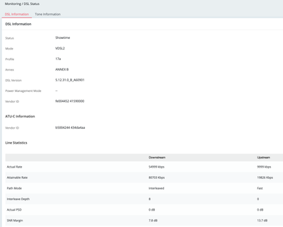

I recently switch to BT, and after the service went live upgraded to Fibre 2 from Fibre 1 on the phone (not offered Fibre 2 during sign up), the change went live yesterday but I only got bumped up to a 55mpbs down 10mbps up profile which is disappointing. I had much higher speeds on NowTV Broadband previously, I changed to BT as their billing was a nightmare (no direct debit.)
My modem thinks the line is capable of 80mbps down and 19mbps up and I had sync speeds just slightly under this on my previous provider. Can anything be done to resolve this?

Fibre 1 is capped at 55/10, fibre 2 is capped at 80/20.

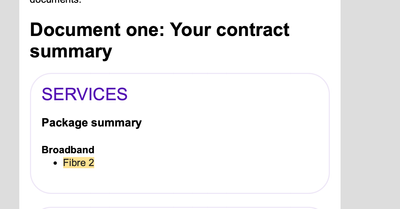

I think you need to check your contract confirmation email, does it show F1 or F2 (irrespective of the conversation you had with the representative) if that shows F2 , clearly you have been mis provided as F1 , if the contract documentation shows F1 you have what you ordered , even if that’s not actually what you wanted (it’s a different argument as to the responsibility for that if the documentation shows F1 but you were led to believe it was F2 you would get ) .
Probably of no benefit but takes little effort, try connecting the router you were sent by BT instead of the non BT router you are currently using , it’s unlikely to do anything, but connecting the BT router may result in a regrade to F2 (if its F2 on the contract documents) , if it makes no difference (and that’s most likely the case ) you will need to call and ask why you are on F1 when you ordered F2 and the contract documentation confirms F2.
If the contract shows F1 (and I suspect that’s going to be the case ) you can always call and ask for a regrade to F2 ( possibly costing a little more than F1 )

Thanks. So the contract was initially Fibre 1, but I upgraded it over the phone. We went through the contractual stuff and I did receive an email after the call that definitely confirms I'm now on Fibre 2, and the billing has gone up too. He gave a go live date for the upgrade of 28th May.
