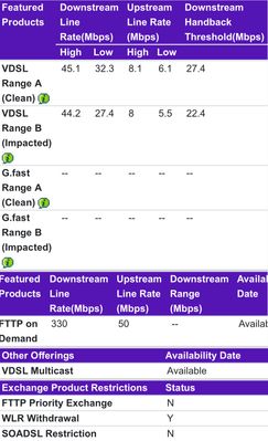

Here is what it shows me:
It says FTTP on Demand as available - can someone clarify what this means and what I need to be looking for? Thanks

FTTP on Demand is an expensive business product and not available to you
can you post the notes that were underneath checker results
3,509 Views
Message 7 of 31
Re: Fibre almost ready? I hope so!
FTTP is not available.
The exchange is not in a current fibre priority programme
As a WLR withdrawal exchange, product restrictions apply
SOADSL is not restricted at the exchange
For all ADSL and WBC Fibre to the Cabinet (VDSL or G.fast) services, the stable line rate will be determined during the first 10 days of service usage.
For all SOADSL services,the stable line rate will be determined during the first 10 days of service usage.
Actual speeds experienced by end users and quoted by CPs will be lower due to a number of factors within and external to BT's network, Communication Providers' networks and within customer premises.
In order to be eligible for handback, downstream speed should be less than Downstream Handback Threshold values.
If you decide to place an order for a WBC fibre product, an appointment may be required for an engineer to visit the end user's premises to supply the service
ADSL, ADSL2+ and SOADSL availability: If shown at FTTP or SOGEA premises,ADSL, ADSL2+ and SOADSL are not available to order due to WLR Withdrawal stop sell rules. CPs should order FTTP or SOGEA. Copper products are only available by exception.

If your property was built early to mid 1990’s or later then it’s probably a ducted feed , so the copper cables are in a duct , that makes upgrading to FTTP relatively easy , no excavation is needed unless ducts are blocked …..that’s probably what the engineer you spoke to was in effect saying ….you currently cannot order FTTP, even when the work is done , it needs to be commissioned , you are not at that point yet .
As far as timescales,  all you can do is keep checking , it may be days , it may be weeks , it may be longer , when the checker shows WBC FTTP as available then you can order  , as far as FTTPod (on demand) is concerned, as stated , that’s something different where you pay to get the network installed and can be expensive, plus  if  ‘native’ FTTP is in the process of being fitted then any order for ‘on demand’ would be rejected.
