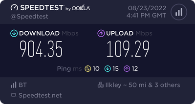

I live on a new build estate and my route was longer than 400m.
There were a number of homes missed off the development for FTTP and it was a struggle to get Openreach to complete, blaming the developer and vice versa.
They pulled a new cable in through a duct, put something additional in a chamber in the footpath and connected to my home.
Results are below (just got BQM running on Unifi yesterday)
