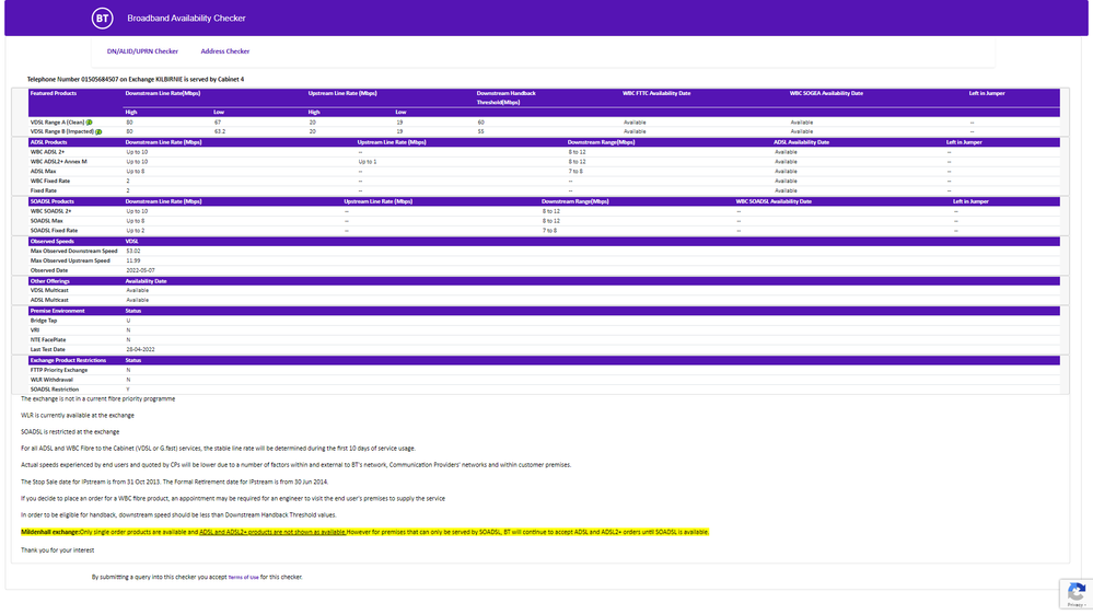

Featured Products Downstream Line Rate(Mbps) Upstream Line Rate (Mbps) Downstream HandbackThreshold(Mbps) WBC FTTC Availability Date WBC SOGEA Availability Date Left in JumperHigh Low High Low        VDSL Range A (Clean) Silverhoop_0-1651951930007.gif
8067201960AvailableAvailable--
8063.2201955AvailableAvailable--
ADSL Products Downstream Line Rate (Mbps) Upstream Line Rate (Mbps) Downstream Range(Mbps) ADSL Availability Date Left in JumperWBC ADSL 2+WBC ADSL2+ Annex MADSL MaxWBC Fixed RateFixed Rate
Up to 10--8 to 12Available--
Up to 10Up to 18 to 12Available--
Up to 8--7 to 8Available--
2----Available--
2----Available--
SOADSL Products Downstream Line Rate (Mbps) Upstream Line Rate (Mbps) Downstream Range(Mbps) WBC SOADSL Availability Date Left in JumperWBC SOADSL 2+SOADSL MaxSOADSL Fixed Rate
Up to 10--8 to 12----
Up to 8--8 to 12----
Up to 2--7 to 8----
Observed Speeds VDSLMax Observed Downstream SpeedMax Observed Upstream SpeedObserved Date
53.02
11.99
2022-05-07
Other Offerings Availability DateVDSL MulticastADSL Multicast
Available
Available
Premise Environment StatusBridge TapVRINTE FacePlateLast Test Date
U
N
N
28-04-2022
Exchange Product Restrictions StatusFTTP Priority ExchangeWLR WithdrawalSOADSL Restriction
N
N
Y
The exchange is not in a current fibre priority programme
WLR is currently available at the exchange
SOADSL is restricted at the exchange
For all ADSL and WBC Fibre to the Cabinet (VDSL or G.fast) services, the stable line rate will be determined during the first 10 days of service usage.
Actual speeds experienced by end users and quoted by CPs will be lower due to a number of factors within and external to BT's network, Communication Providers' networks and within customer premises.
The Stop Sale date for IPstream is from 31 Oct 2013. The Formal Retirement date for IPstream is from 30 Jun 2014.
If you decide to place an order for a WBC fibre product, an appointment may be required for an engineer to visit the end user's premises to supply the service
In order to be eligible for handback, downstream speed should be less than Downstream Handback Threshold values.
Mildenhall exchange:Only single order products are available and ADSL and ADSL2+ products are not shown as available.However for premises that can only be served by SOADSL, BT will continue to accept ADSL and ADSL2+ orders until SOADSL is available.
Thank you for your interest
Featured Products Downstream Line Rate(Mbps) Upstream Line Rate (Mbps) Downstream HandbackThreshold(Mbps) WBC FTTC Availability Date WBC SOGEA Availability Date Left in JumperHigh Low High Low        VDSL Range A (Clean) Silverhoop_2-1651951930218.gif
2----Available--
2----Available--
Up to 2--7 to 8----
53.02
11.99
2022-05-07
Available
Available
U
N
N
28-04-2022
N
N
Y

We can see the info OK (although a screenshot would normally be better) so don't worry. The missing info is exchange and cab number. We need to be able to fing out which type of cab you are connected to and can only do that with the above.
G.INP is only available on Huawei Cabs but the connection stats seem to indicate you are on an ECI cab.
If ECI, your stats look OK if not...

Re: Fluctuating download speeds
have you tried using the test socket with a filter to see if that helps your connection speed.  the front of master just unclips and should be secure.  the test socket is visible when front removed.
You are on Huawei cab so with a stable connection you should get a boost when G.INP kicks in which can take 7/10 days stable
