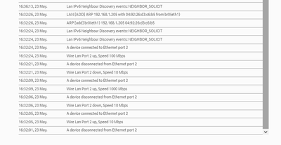

Trying to narrow down my neverending problems. Two engineers down, I know there'll be many more to come, as always. I'm scanning the event log to see if anything is out of the ordinary. Just had a ton of disconnections within 15 minutes, can't get any work done so... here I am!
Can anyone please tell me if this is normal:
The flip flopping between 10mbps, 1000mbps and 100mpbs.
Thanks so much for helping me perhaps narrow things down.

I did continue on the other post, to no avail. I was hoping maybe new eyes would spot something weird in the event log. It's not noise on the line, with a wired phone it is the same as it always has been. I am not a professional so I don't know what it should sound like - I just know it sounds the same, but the professional Cube guy did a noise test too and he didn't say anything about it.
So I'm here hunting things down, hoping someone sees something I don't. Problems with my line are never easy to spot or solve... pure desperation at this point! Please have patience with me.
For e.g. if someone could advise me, is checking event log pointless? Does it ever offer up clarity about disconnections? That's the kind of thing I'd love info on currently!

I would not bother with the logs as stats are more informative
