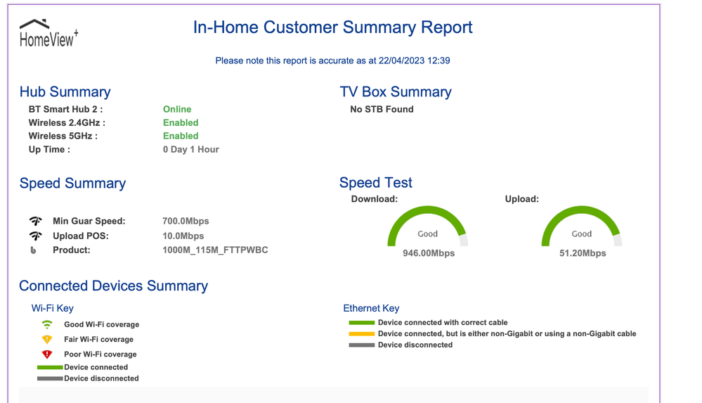

just ran a speed test now on wifi
https://www.speedtest.net/result/14657130920

Anyone help guide to to connect either my macbook directly to the ONT. to do a speedtest bypassing router,

Re: Full Fibre 900/100. Slow speeds
https://support.apple.com/en-gb/guide/mac-help/mchlp27142/mac
PPPoE details are the generic username [email protected] and password BT
