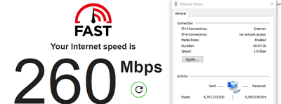

Yes, direct connection, and for a test all other devices disconnected.
Still sees a max speed of approx 200Mbps.
