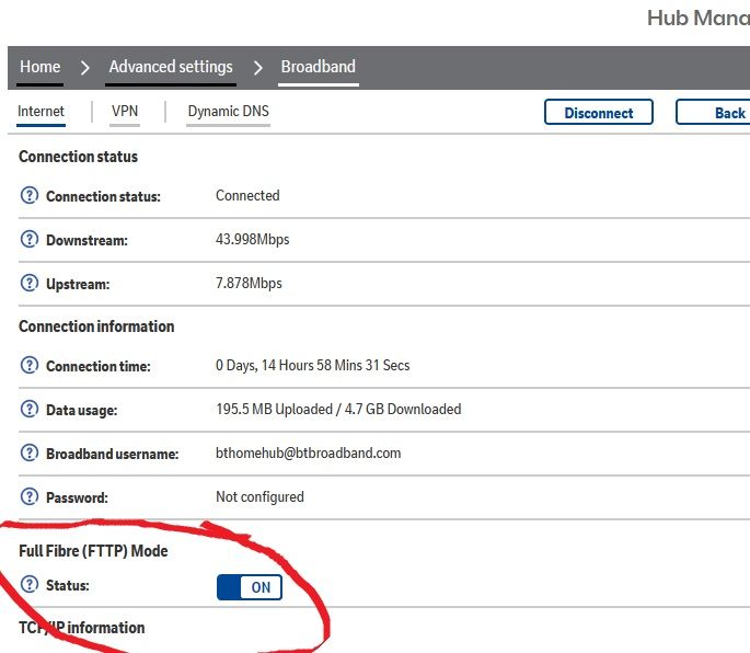

But is the WAN port configured as a WAN port? Port 4 is either a LAN port or WAN port.
You need to make sure FTTP mode is enabled. Advanced Settings > Broadband > Internet

Thanks for your reply and I have just checked full fibre fttp mode is indeed on
