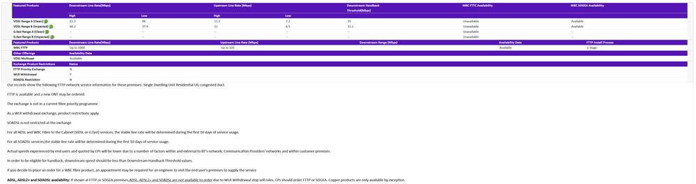

I've checked the BT broadband availability checker and it doesn't look like my block is in openreach's plans to roll out fibre. I am stuck on a 40Mbps line which is quite limiting. Screenshot my my address below:
It does however show FTTP 330Mbps on demand available? I have never been able to order this.

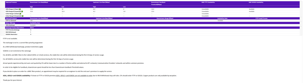

My neighbours who live in a freehold house had fibre installed last year. The chamber from which the civils was done to their house is less than 20m from my block. Details for their address below on the availabilty checker:2025-07-15 19_45_02-BT Broadband — Mozilla Firefox.png
