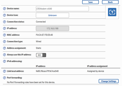

Hi there, I currently don't use the DHCP, DNS or WiFi from my Smart Hub 2, it only routes and provides the Digital Voice service.
I am unable to get the Hybrid Connect device to pair with the Smart Hub 2, it simply flashes green forever.
I have tried factory resetting the Hybrid Connect, with no luck, the device does show in the Connected Devices table, but still, the BT hub won't pair with it.
Any ideas?

Thanks, it is a normal residential Smart Hub 2. I've tried leaving it for 30 minutes, even under factory settings, aka leaving the BT router on it's default IP and subnet, with DHCP on.

Yes it's always best to connect the two devices when their on their default settings so to speak.
Then once connected, you can go back through settings and turn off certain features that you don't require.
The Hybrid Connect will just be connecting to the DHCP server in the Smart Hub 2, and that would assign the IP address for it.
So, in theory, if you're using your own DHCP server with DHCP turned off on the Smart Hub 2, then it should just get an IP address from your server instead.
Unless somewhere in the firmware it doesn't like that method and will only pair if using DHCP from a Smart Hub only, especially if you're trying to use static IP addresses, as all IP addresses allocated by a router are allocated via DHCP.

“So, in theory, if you're using your own DHCP server with DHCP turned off on the Smart Hub 2, then it should just get an IP address from your server instead”.
Just a thought…if you are running your own router as a different subnet then this will give the Hybrid unit an address in the wrong range.  (If it worked at all).

I think the OP has tried with the hub in its factory default state without success.
@droidd are you sure your account is correctly configured as Halo3+ you need to confirm that with customer services.

Yep, Halo 3+, it was configured when the engineer did the install

I only have the one router, I have a separate DHCP server running in the same subnet as the BT hub
